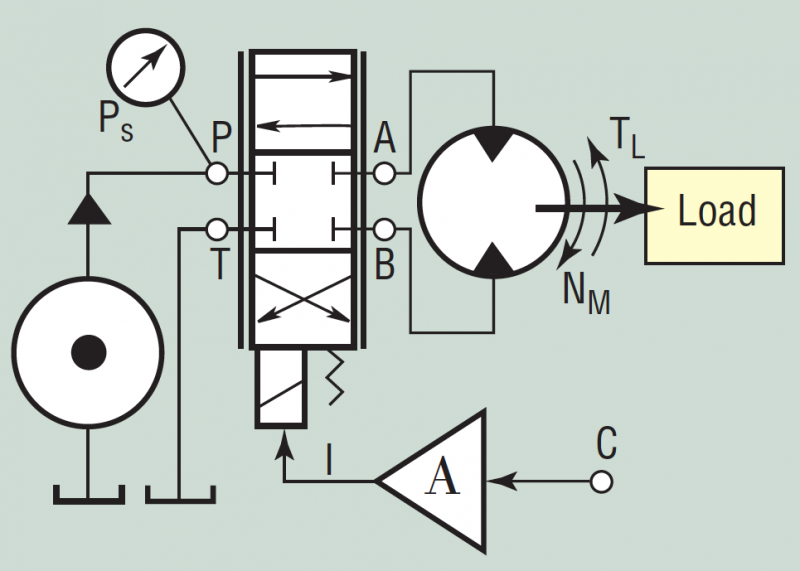

Figure 1. Valve control of motor speed uses a constant pressure source; a closed center 4-way proportional/servo valve; the motor to be controlled, which propels a load torque at some speed; and an amplifier to supply controllable current. Click on image for larger view.
A typical valve-controlled system is shown schematically in Figure 1. The design of the speed control system consists of two parts. The first is optimal sizing of components so that maximum power is transferred to the load at the design point. The second is a feedback control method configured to provide a wide enough speed range and degree of speed control to maintain constant speed of a changing load.
Consider an application, such as a conveyor drive, where the load varies at any given moment, and the speed must be adjustable or synchronized with some other process action. The design point is the single, worst-case operating point where the power required by the load is greatest. It consists of the load torque requirement at the design point, TL,DP, and the speed required at that torque, NM,DP.

Optimal sizing, also called optimal design, involves evaluating and selecting the three key hydraulic parameters: supply pressure, PS, valve coefficient, KV,T, and motor displacement, DM, such that maximum power is transferred to the load at the worst-case design point.

Of course, the supply pressure must equal the sum of the differential pressure losses for the valve lands and the motor. Figure 2 helps illustrate the various pressure drops. From a knowledge of hydraulic circuit analysis, it is further known that the valve pressure losses relate to the square of the flow through each respective valve coefficient.
