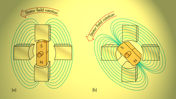

When viewing the construction details, ac motors are simpler than dc motors. Complications arise regarding the sequence of energizing the stator.  One of the subtle points often missed in studying this motor is that the stator windings create an electromagnetic field with a composite (effective) axis that shifts rotationally during the sequence.
In Figure 7a, the effective stator magnetic axis is vertical, thus “grabbing” the rotor permanent magnet and aligning it as shown. In the Figure 7b sequence, the central effective axis has shifted 45° clockwise. The motor works because the stator field is rotating.

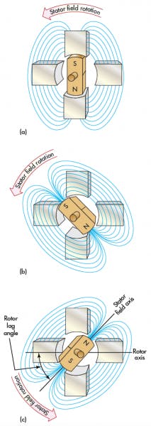

9. In this two-phase, two-pole, ac-powered motor, the two stator windings produce a magnetic field that rotates synchronously with the frequency of the ac supply voltage. Following that is the magnetized rotor synchronized with the rotating field, but lagging by a “lag angle” when load torque is applied. (For simplicity, windings and external circuits were omitted.)
Figure 9 illustrates the rotating field and rotor synchronization idea. The rotating field is the basic concept surrounding ac-powered motors, and the main reason why their construction is simpler than dc motors.  The field rotates at its synchronous speed (described in the equation provided later in the article).  The magnetic rotor, naturally, locks onto the rotating field and spins along with it (Figs. 9a and 9b).
Figure 9c illustrates the effects of adding external load to the motor output shaft.  The rotor of the synchronous motor must spin at the same rate rotational speed of the stator field.  The application of external load torque, then, does not reduce speed in the conventional sense.  Any speed reduction is only momentary—applying external torque causes the rotor to slow, but as the rotor position begins to lag behind the stator-field rotation, the force of attraction between the rotor and the stator fields causes the motor to develop more torque to meet the load demand.
At some point, the magnetically induced torque equals the load torque, and the motor again locks onto the rotating stator field. Subsequently, the rotor again spins at synchronous speed, albeit by a lagging in angle. Speed measurement under loaded conditions will point out this fact.  The rotor under load, however, will lag by an amount called the rotor lag angle.
Increased load torque does not slow down the synchronous motor.  The maximum torque developed by the motor occurs when the lag angle reaches 90°. When that occurs, the rotor drops out of synchronism and stalls. The result is a sudden increase in stator currents and potential destruction of the motor due to overheating.
