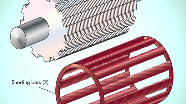

10. The rotor of the “squirrel cage” induction motor consists of a laminated rotor structure with slots. The conductors are placed into the slots and capped off on each end with shorting bars.

Given that the induction motor uses a rotating field for its ultimate propulsion, its stator will be similar to that of the synchronous motor, except that it will most likely be three-phase, not two-phase. Regardless, the rotor construction consists of a series of ferromagnetic laminations mounted on a shaft (Fig. 10). The laminations are electrically isolated from one another with lacquer or varnish coatings to minimize eddy-current heating in the iron.
The term “squirrel cage” comes up because of the way that the rotor conductors are arranged. The isolated conductor cage is also shown in Figure 10. In the final rotor assembly, the individual conductors will be inserted into their respective slots in the laminated rotor.

In the rotor pictured, 12 conductors are in the squirrel cage and 12 slots are in the laminations to receive the conductors. When assembled (Fig. 11), the composite rotor is round and generally quite smooth because the conductor cage surrounds the laminations and helps hold the assembly together. The conductors are held together with shorting bars on each end of the cage. In the functioning motor, currents are induced into the rotor conductors. The currents are allowed to “circulate” by virtue of the shorting bars.
