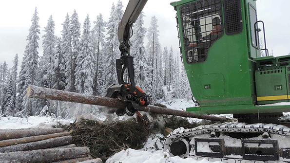

Off-highway equipment such as this log harvester have to transmit hydraulic fluid between the non-rotating boom and the rotating processing head. It also has to transmit electrical power to operate valve solenoids in the head. Combining a hydraulic swivel with an electrical slip ring is holds advantages over using two separate components.
