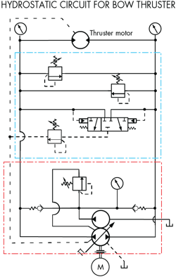

Despite flooding of the Ohio River this past spring, a large party riverboat was able to continue operating using its side thruster to facilitate docking, even though high forces from the rushing river occurred. But one day the thruster simply stopped working.
June 10, 2015
3 min read
Despite flooding of the Ohio River this past spring, a large party riverboat was able to continue operating using its side thruster to facilitate docking even though high forces from the rushing river occurred. The main propellers provided more than enough thrust to move the boat ahead and astern , and steering to port and starboard was not a problem. The side thruster allowed docking the boat at an angle as the crew navigated the craft sideways, aligning it parallel to the dock.
However, the thruster suddenly stopped working one day, so we were contacted to investigate. The Captain said a diesel engine was driving a gearbox for the side thruster drive, and when they engaged a driveline clutch, the main pump appeared to be rotating. However, they could not get any rotation of the thruster props.
The cruise line’s mechanic told us that the original 0- to 600-psi pressure gauge mounted on the pump was broken, so he replaced it with a 0- to 6,000-psi gauge from one of the main system pressure lines. The charge pressure should be about 250 psi for the main pump, and it would be difficult to read that low a pressure from a 6000-psi gauge.
We looked to see if there was any movement of the gauge needle when the system was energized, but we could not see any at all. The servo control mounted on the pump seemed to function both manually and electronically but the pump would not turn the props in either direction.
Any idea what the problem turned out to be?
