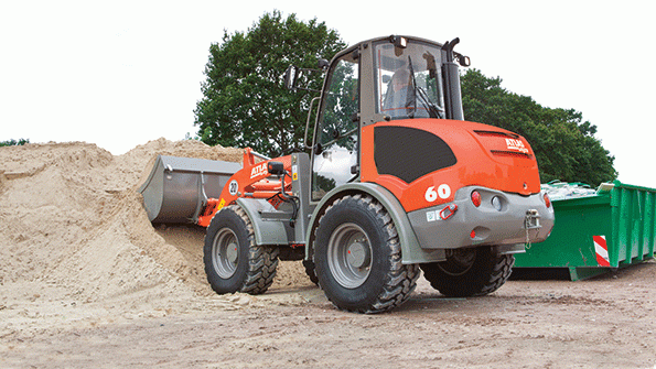

The entire system, in our preliminary model called the AR 60 start-stop, consists of a Rexroth A10VO pump, a BODAS control unit, an automatic start-stop valve manifold, and four reservoirs, each with a volume of 0.6 liters. This is a highly manageable package when compared to the electrical solution.
Space plays an important role in a compact wheel loader. It is far from easy to find room for additional equipment. We used to fit a 23-cm³ gear pump to power the implements. For the automatic start-stop system, we will be using a 45-cm³ variable-displacement pump capable of pressure to 280 bar. We ascertained in our CAD analyses that it would fit nicely into the engine compartment without modification, even though it is a relatively large unit.
The accumulators, on the other hand, were easy to deal with because we were able to fit them underneath the cab. Accumulators do not have to be easily accessible for maintenance, nor do they generate appreciable noise.
