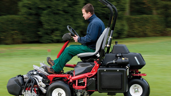

Toro’s Greensmaster riding mower uses a patented triplex hydraulic traction system to manicure golf-course greens even when they are wet and slippery. Click on image for larger view.

To solve this maneuvering problem, The Toro Co., Bloomington, Minn., has designed and patented a hydraulic traction circuit that enables a groundskeeper to easily manicure golf greens with the speed and convenience of a riding mower. The traction arrangement on Toro’s Greensmaster riding mower has a triplex configuration, with two drive tires in front and a steering tire in back. Its hydraulic circuit plumbs the front wheel motors in parallel with each other, then adds a third motor at the rear wheel and plumbs it in series with the front two. The rear motor has twice the displacement of each front motor, and the tires mounted on all three wheels are the same size to maintain the correct speed ratio.
With Toro’s circuit, the machine will continue to move on wet or uneven turf until one front tire and the rear tire slip. Traction while climbing grades, especially on a diagonal line, is significantly improved compared to 2-wheel drives or simple parallel 3-wheel drive systems, because Toro’s rear wheel will continue to push even if a front tire loses traction. In addition, rear-wheel traction is improved because weight transfers from the front wheels to back when going uphill.
It is difficult in almost any drive configuration to maintain the correct speed ratio between the front and rear tires during turns. The tricycle layout of the Greensmaster means the rear wheel must turn faster than the average of the two front wheels while turning. In the patented Toro system, an overrunning clutch allows the rear tire to overspeed during turns to maintain gentle, even traction.
