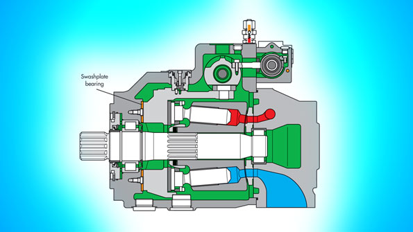

Roller-type, swashplate bearings in axial-piston designs are prone to premature failure caused by brinelling. But in the A4VO pump, the swashplate bearings are shell-type (more like a bushing than a bearing). Potential brinelling (and subsequent failure) of the swashplate bearings, then, is not an issue (see the figure).
Rolling-element swashplate bearings in axial-pistons are subject to brinnelling, which limits pump life. Pumps with a lightly loaded swashplate can instead use shell-type bearings, which are not subject to brinelling.
Based on my experience and knowledge of this model pump, I’d look for a service life of between 10,000 and 20,000 hr. But this is a very wide range, so consider some of the issues that could determine if its achieved service life may be at the lower or higher end of this scale.
