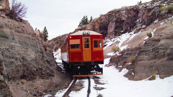

Self-propelled rail cars transport passengers to Machu Picchu using hydraulic motors driving two axles, with power to spare. A third motor can be engaged to provide power to an additional axle for towing a disabled car.

Before shipment to Peru, the M101 car was given a trial run on the Cumbers & Toltec scenic narrow gauge railroad in a little-known corner of the southern Rocky Mountains. “The test,” Thomas beamed, “covered 50 miles (80 km), running from 7500 ft (2286 m) above sea level to 8500 ft (2590 m). The car maintained a speed of 25 mph (40 km/hr) up 2% grades, and 20 mph (32 km/hr) on 4% grades. Curves of 22° were easily handled at 20 mph. Importantly, the ride was smooth with no bouncing, rocking, or swaying.”
