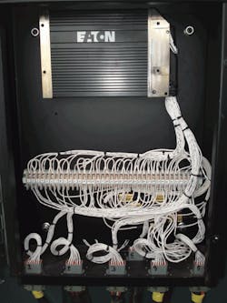

Four Eaton EFX programmable controllers are equipped on each AFE potato harvester.
For years, DTS Fluid Power, an Eaton distributor in Grand Rapids, Michigan, has been supplying hydraulic components to AFE for the airhead machine and other equipment. DTS engineers worked with Merrihew’s design team to develop an all-hydraulic version of the airhead-type machine. The new version uses the latest technology to deliver higher performance while streamlining the manufacturing process and increasing productivity.
“Eaton is one of the primary proponents of merging hydraulics and sophisticated electronics into integrated electrohydraulic systems,” explained DTS’ Trent Tegg, vice president of sales and marketing. “Eaton offered a single source for nearly
all the hardware and software AFE needed to produce a really revolutionary product — everything from the programmable touch-screen display in the cab to the high-performance pumps, motors and valves that make things happen deep in the heart of the beast.
“It’s all tied together with Eaton EFX CAN controllers that communicate with device-mounted electronics via a single CANbus cable. The machine can be preprogrammed to match the user’s exact conditions, and the operator can change functions on the fly as things change.”

The switch to an all-hydraulic design controlled via CAN and CANbus wiring has reduced the number of man-hours required to assemble the airhead, while the electronics have greatly enhanced the machine’s capabilities. “Eaton’s CANbus system eliminates a lot of wiring,” Merrihew said, “about 3,000 or 4,000 ft per machine. The plumbing is a lot simpler as well. For example, the electronically controlled pumps only deliver the amount of power that’s needed, so they generate a lot less heat. There is no wasted flow,
