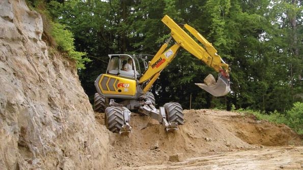

Menzi Muck AG, Widnau, Switzerland, makes all-terrain excavators named after a legendary elf, Mr. Muck, known as “the little man who does everything.” Menzi Mucks allow each leg or wheel to be raised, lowered, extended, retracted, or moved in or spread out so the operator can adjust the working base of the machine to conform to the terrain. This control provides extreme maneuverability and remarkable flexibility, stability, and safe operation.
The Menzi Muck A91, one of five different sized models, can climb and work up, down, and across steep slopes, in 7 ft of mud and water, in tight spots, or in bad weather that mires down other equipment. All the while, the operator sits comfortably upright, with a full 360° view and precise control, regardless of the terrain.
The Menzi Muck A91 uses electrohydraulic pump control that overcomes limitations of conventional load sensing and flow sharing systems
The basic version of the Model A91 features two-wheel drive, telescopic stabilizers, and full 360° rotation of the cab. Options include all-wheel drive, variable parallel wheel track widths, all-wheel steering, parallel or mountain stabilizers, and a host of others, all powered by hydraulics.
