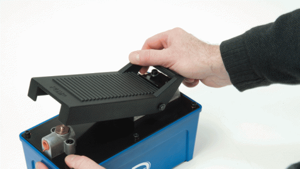

Portable air hydraulic pump is designed for use with hydraulic vises, cluster towers and swing clamps. Rated for pressures to 5000 psi, it provides constant hydraulic pressure and holding power for precision clamping applications. It is driven by an efficient air motor and operated with an easy-to-use foot pedal.
Hydraulicspneumatics Com Sites Hydraulicspneumatics com Files Uploads 2012 04 Kurt Pump Pr 01
Portable air hydraulic pump is designed for use with hydraulic vises, cluster towers and swing clamps. Rated for pressures to 5000 psi, it provides constant hydraulic pressure and holding power for precision clamping applications. It is driven by an efficient air motor and operated with an easy-to-use foot pedal. It maintains constant pressure when the foot pedal is depressed regardless of system pressure, ensuring accurate and repeatable clamping pressure with every clamping cycle.
An internal load limiting valve protects against overload, while an air exhaust muffler provides extra quiet operation. Air and oil filters protect system from environmental contaminants. It operates with ordinary shop air at 90-145 psi input pressure.
