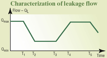

Leakage resistance
Referring to Figure 1, equations were developed to simulate a single cycle of the trapezoidal waveform. T1 was chosen as an arbitrary reference point. The remaining values, T2, T3, and T4, were used to derive a set of four straight-line equations involving minimum and maximum flows, Qmin and Qmax, respectively.
Because the wave form is periodic, only one cycle needs to be simulated. Therefore, the position can be calculated and translated back to this fundamental cycle.
The actual flow, Qq , is based on the angular position, , of the shaft. This value must be transformed into time to be used by the simulation.
Instantaneous motor displacement
The instantaneous motor displacement is based on Tp(q), the torque obtained during the low-speed test and P, the pressure during the test.
Because the waveform for Tp (q) and Q (q) are similar, the same set of equations can be used to produce the trapezoidal model of Figure 1. The maximum and minimum torque can be obtained from input data.

Figure 1. Internal leakage of a motor varies with shaft rotational position. This is caused by the changing volume of the pressure chamber as the shaft rotates.
