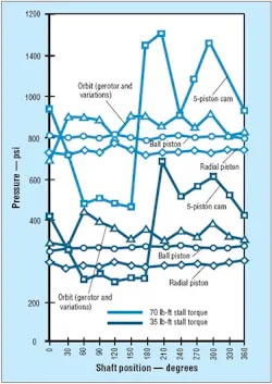

Stall torque — Both electronic and hydraulic drives can produce a consistent stall torque. The electronic motor requires a torque-limiting control circuit to prevent motor damage. A hydraulic motor with standard pressure control can maintain stall torque for long periods without damage. A hydraulic motor that exhibits no volume change during the 360° of rotation displays constant stall torque that, again, can be held for long periods without damage.

Fluctuations in stall torque relative to shaft position indicate torque ripple produced by various hydraulic motor designs. Note how this condition varies with pressure for most designs.
