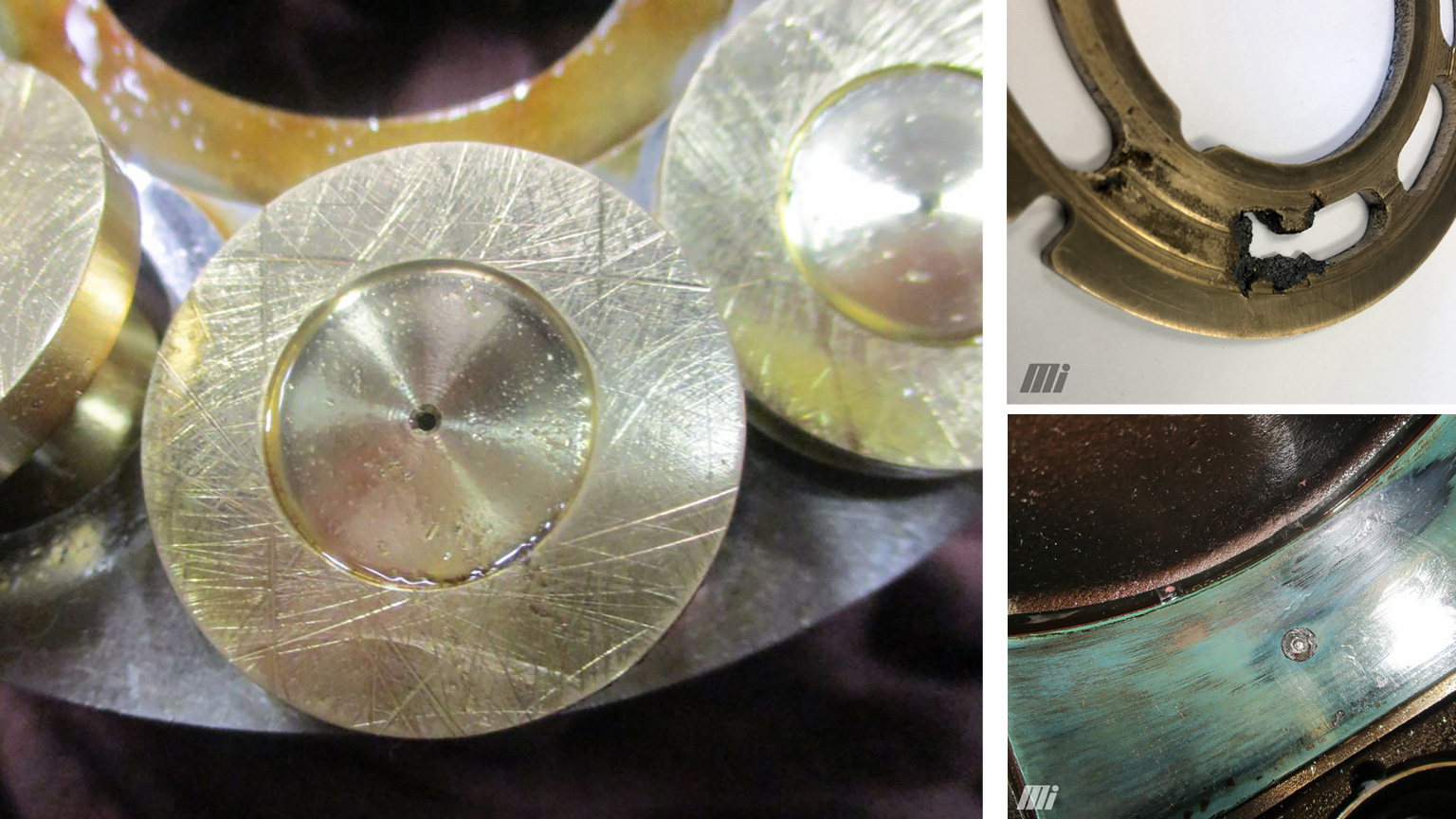

The four most common modes of failure in piston pumps result from oil contamination, fatigue that results from transient pressure spikes, blocked or restricted pump inlet, and pump case over pressurization. These four modes account for the vast majority of all failures seen in the thousands of units inspected and repaired each year by the service technicians working at Motion Industries.
Contamination can be the result of many things, including egress of water, environmental contaminants or component ware elements. Telltale signs of contamination include valve plate scoring, vertical scratches on piston barrels, scratches on the face of pistons, excessive wear of saddle bearings (or embedded particulate), plugged orifices, stuck compensator spools and pistons being seized within the cylinder bore of the barrel.

Blocked or restricted pump inlets will typically present in the form of cavitation on the valve plate or what some service technicians refer to as a “marble sound.” Vacuum at the inlet leads to the formation and collapse of small vapor-filled voids. The shockwave generated by the collapse of these voids leads to the surface damage on the valve plate as well as the telltale sound.

Pump case over-pressurization can present in the half-moon gouging or full-moon scoring of the swash plate, damaged shoe retainer, bent seal retainer or protruding shaft seals as well as shoe damage—rounded edges, loose fit on the ball and excessive wear on the backs of the shoes. This kind of damage will be the result of shoe lift or rolling caused by the increased case pressure. This condition can be monitored through the use of a pressure transducer in the case line. In practice, however, this is rarely done.
