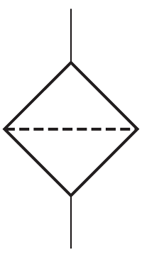

Filter technology has advanced considerably in recent decades due to industrial and academic research-and-development efforts. The status of the filter element is best indicated by the differential pressure drop across the filter. As it continues to do its removal work, the myriad tiny flow paths become blocked by particles accumulating in them.
1. This is the ISO standard schematic symbol for a hydraulic filter.
Some filters are equipped with integral low-pressure relief valves that allow fluid to bypass should the filter become seriously restricted. The rationale is that it is a safer situation to enable contaminated fluid to circulate through the system than to allow all flow to be blocked. But, obviously, the filter element should have been changed before the occurrence of such an extreme condition.
The standard ISO filter schematic symbol is shown Fig. 1. They are normally drawn with fluid entering the upper port and leaving through the lower. However, that is merely common practice, not standardized practice.
