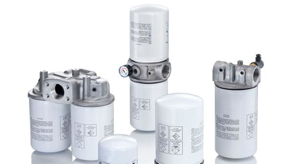

Sometimes you can ask 10 people the same question and get 12 different answers. That's no good if you’re gathering eyewitness accounts of a crime. But if you’re looking for the most effective ways to improve machine operation and reliability, the more information you have, the better.
We queried hydraulic filtration product suppliers about some of the best practices people can follow to hold fluid contamination at bay—especially when on a tight budget. Here's a summary of their responses:
When you startup and flush a new system, consider using a finer grade of filter media for the first element used. For example, if the system uses 10 µm media, start the flush with 6 µm. At the next element change go back to 10 µm. Benefits are: no 6-µm or larger contaminant, rapid stabilization of system contamination level, minimal element usage, and greatly reduced potential of premature failure.
