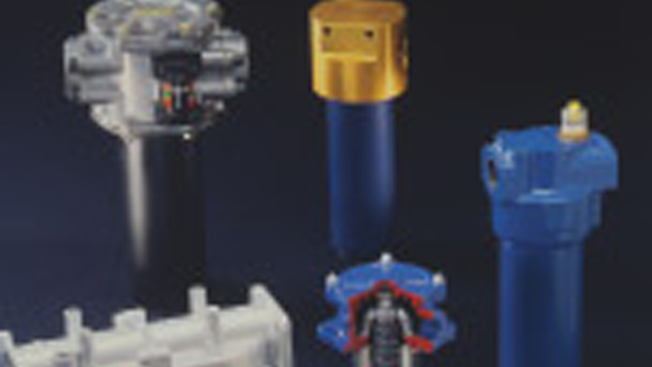

It’s all about location
Consider the pros and cons of each location when choosing where to include filters in a hydraulic system.
Because the primary objective of filtration is to extend machine life by removing contaminants from the oil, it is a paradox to locate filters in a hydraulic system where they reduce the service life of the components they were installed to protect. So when selecting the locations for filters in a hydraulic system, the overriding principle must be: first, do no harm. In other words, ‘the cure must not be worse than the disease.’
With this in mind, let us consider the pros and cons of the various hydraulic filter locations:
Pressure filtration
Locating filters in pressure lines provides maximum protection for components located immediately downstream. Filtration ratings of 2 μm or less are possible, due to the pressure that is available to force fluid through the media. However, filter efficiency can be reduced by high flow velocities and pressure and flow transients, which can disturb trapped particles. The major disadvantage of pressure filtration is economic. Because the housings and elements must be designed to withstand peak system pressure (high-collapse type), pressure filtration has the highest initial and ongoing cost.
Return filtration
The rationale for locating filters in the return line is this: if the reservoir and the fluid it contains start out clean, and all air entering the reservoir and returning fluid is adequately filtered, then fluid cleanliness will be maintained. The other advantage of the return line as a filter location is that sufficient pressure is available to force fluid through fine media (typically 10 μm), but pressure is not high enough to complicate filter or housing design. This, combined with relatively low flow velocity, means that high filtration efficiency can be achieved economically.
Vacuum here or case pressure here puts the piston-ball and slipper-pad socket in tension.
For these reasons, return filtration can be beneficial for most hydraulic systems. The main disadvantage of return line filtration is that the backpressure created by the element can adversely affect the operation of or even damage some components.
Off-line filtration
Off-line filtration enables continuous, multi-pass filtration at a controlled flow velocity and pressure drop, which results in high filtration efficiency. Filtration of 2 μm or less is possible, and polymeric (water absorbent) filters and heat exchangers can be included in the circuit for total fluid conditioning. The main disadvantage of off-line filtration is its high initial cost, although this can usually be justified on a life-of-machine cost basis.
