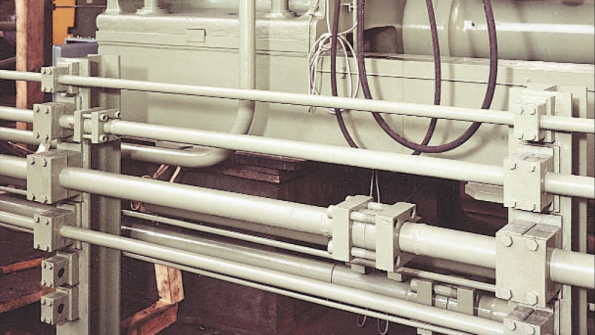

Clamps on vertical structural members hold horizontal piping runs in place, limit vibration and shock, help control noise.
Pipe supports should control vibration and absorb shock. Pumps and valves are the greatest cause of vibration and shock, owing to the drastic pressure and fluid velocity changes that occur in these components during operation. While intensive research has reduced pump- and valve-induced vibration, it is still considered a problem for the entire piping and tubing system. Through piping and tubing, vibration, shock, and related noise are transmitted and amplified. Note that pumps are the greatest source of noise, and reservoirs provide the strongest amplification.

After analyzing your hydraulic system, route your tubing by the most direct route. One manufacturer suggests routing lines along the bases of the machines. Beware of obstructions, moving parts, contours, and service openings. Plan around them: If the base routing is not economical, consider upright carriers for partial line suspension. If this is not practical, full overhead suspension is the last resort.

Other multi-clamp sections, and some individual clamping models, have feet or brackets, which are welded to the supporting surface. The lower half of some are simply welded in place. Some individual clamp types can be anchored in channel-type metal pieces, which are welded or bolted to the support surface, and again allow designing the overall clamp assembly as wide as desired. Most support systems can be mounted on strut-type rails that already may be present in some installations, allowing light-duty hydraulic and pneumatic lines to run alongside water and gas lines.
