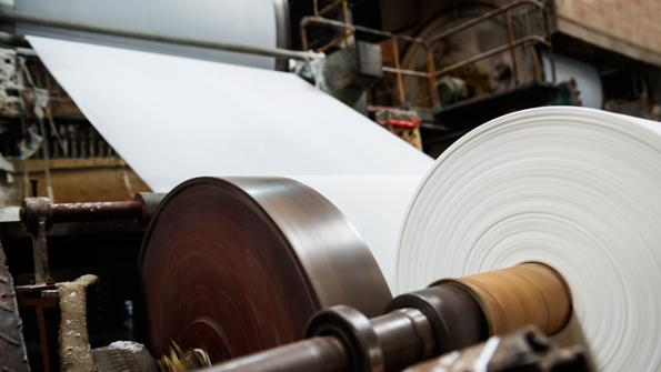

Technicians at a paper mill were puzzled by hydraulic hoses pulling loose from their end fittings.
May 6, 2016
3 min read
Technicians at a paper mill were puzzled by hydraulic hoses pulling loose from their end fittings. Before this problem began, the workers had replaced a screw-in safety relief valve with an incorrect valve—its P and T ports were reversed.
This relief valve caused the swashplate in the hydraulic system’s pressure-compensated piston pumps to break a couple of times within a two-month period. The cause was determined to be pressure spikes that reached 9,000 psi, even though the pump’s compensator setting was 1,000 psi. These spikes resulted from a safety relief valve not functioning properly. The relief valve problem was discovered and corrected, but then the hose-end failures began.
Technicians made hose assemblies for various machines of the paper line in a room equipped with the proper fittings for the hose they stocked. Workers made sure the hose was inserted into the fitting at the proper depth and that they used the proper die set for crimping the fittings onto the hose. The working pressure rating for each hose assembly was 400 to 500 psi higher than system pressure.
As the hose failures occurred, technicians looked, again, for pressure spikes, but couldn’t detect any.
What was causing the hoses to pull away from their end fittings?
