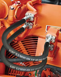

Whether your company manufactures new equipment or repairs existing equipment, hose routing can sometimes pose a real challenge. With today’s Tier-4 engines consuming more space within engine compartments, routing a hose from point A to point B can be tougher than ever. If you’re lucky, you’ll find a way to snake a hose around multiple obstacles. If luck isn’t on your side, you’ll have to remove and replace components to route a hose. Even outside the engine compartment, as equipment designs become more compact, placing components within a smaller envelope also presents greater challenges.

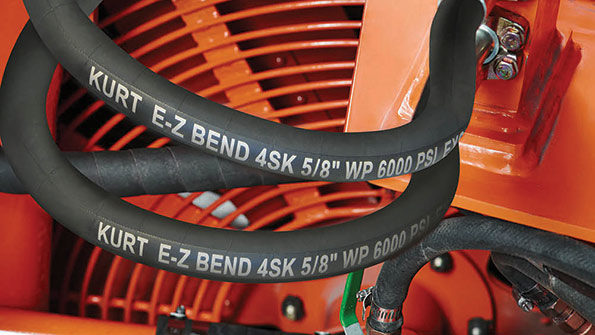

Fortunately, these challenges became a little easier with the introduction of E-Z Bend hose developed by Kurt Hydraulics, Minneapolis, Minn. E-Z Bend hose has half the bend radius of standard hose for easier routing. Providing greater flexibility and strength, E-Z Bend hose suits today’s compact applications that require hydraulic hose with tight bend radius using minimal installation force.
Targeted at high-pressure hydraulic oil lines in mobile and industrial hydraulic systems, E-Z Bend hose features four spiral layers of high-tensile-strength steel wire. Its inner tube is constructed of oil-resistant synthetic rubber. The hose’s working temperature range is –40 to 212°F, and it meets MSHA flame-resistance requirements.
E-Z bend comes in four standard sizes: ⅝, ¾, 1 and 1¼ in. Working pressures range from 5,000 to 6,000 psi, and minimum burst pressures extend from 20,000 to 24,000 psi (both depend on hose size).
