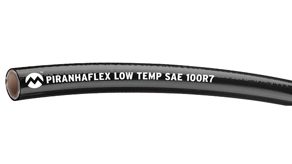

Piranhaflex PFLT364 hydraulic hoses from Piranhaflex PFLT364 hydraulic hoses from Kuriyama of America, suitable for use in medium-presusre hydraulic lines, operate over a temperature range of -65˚F to 200˚F.
The Piranhaflex Series PFLT364 Low Temp 100R7 Hydraulic Hose is suited for medium-pressure hydraulic lines, and has an extended service life in cold storage applications. The hoses feature three layers: a seamless copolyester inner tube, braided fiber reinforcement for high tensile stress, and a black copolyester pin-pricked cover. Temperature range is -65˚F to 200˚F for petroleum-based hydraulic fluids. Available in 250 ft. reels with 0.250 in., 0.375 in., and 0.500 in. inner diameters, the hose meets SAE J517 and J343 Standards.
