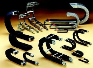

Hose and cable carriers
Hose and cable carriers form a flexible shield that pays out and retracts the hose with a smooth, rolling action, which keeps the lines from becoming tangled and prevents fatigue.
Hose carriers can be divided into four basic types: metal link, metal enclosed, non-metallic link and non-metallic enclosed. Each type is best suited to a different combination of application parameters, although the choice is not always clear-cut.
Metal link carriers are simply parallel sidelinks joined by crossbars that accommodate the hoses. Pivot pins and stops allow the links to travel through a predetermined arc. These designs are best for slow-speed, heavy-load applications such as machine tools.
Metal enclosed carriers are formed with small convolutions to provide better protection against chips, weld spatter and other particles. Because carriers of this design are not limited by individual links with their distinct travel arcs and stops, they also can operate at higher speeds, an advantage in applications such as robotics.
Non-metallic link carriers can handle higher speeds while providing greater width and carrying capacity, for applications where greater weight-and hose-carrying capacity are needed for longer travels. This type leaves the hoses open to easy inspection but does not protect against abrasive particles.
Non-metallic enclosed carriers are the best choice for applications that combine the need for fast travel speeds and protection from outside elements.
Few of the lines between parameters are clearly drawn, so it is best to begin working with the hose carrier manufacturer early in the design of any equipment with hydraulic or pneumatic lines that connect moving parts. This will allow greater flexibility in choosing the hose carrier design that will provide the best combination of features for the application.
Here are a few general guidelines for making a preliminary selection. For size decisions, the practical maximum width for an enclosed metal enclosed carrier is about 6 in. Very small sizes, conversely, are easily handled in non-metallic designs, while they are not practical in the metal-link types.
Metal link carriers are restricted to speeds under about 80 ft/min in most applications, although by controlling acceleration and deceleration, considerably higher speeds have been achieved.
Most non-metallic carriers are molded from fiberglass-filled nylon, which provides high strength per unit weight. However at about one-fourth the strength of steel, such materials are not practical for carriers combining large widths, the weights of multiple lines, and long lengths.
These factors all interact to determine the final choice. For example, a low-speed application with moderate particle exposure would probably call for a metal link design. A combination of higher speed and hot welding or grinding spatter would point toward a metal tube. A high-speed application with the need to monitor hoses for leaks would indicate an open non-metallic design, particularly with a large number of hoses. A high-speed application that also needs corrosion resistance — such as a car wash or a machine with heavy coolant spray — would be a logical place for a non-metallic enclosed carrier.
