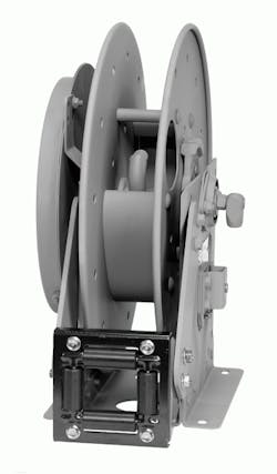

N500 series high-pressure, spring-rewind reel is designed for efficient hydraulic or air hose handling. Heavy-duty spring motor with self-contained rewind power, four-way roller assembly and a declutching arbor prevent against damage from reverse winding.
Feb. 4, 2013
N500 series high-pressure, spring-rewind reel is designed for efficient hydraulic or air hose handling. Heavy-duty spring motor with self-contained rewind power, four-way roller assembly and a declutching arbor prevent against damage from reverse winding. Non-sparking ratchet assembly locks reel at desired length of hose payout and a pull on the hose unlocks it for the spring motor to retract it. They handle single 1⁄4 or 3⁄8 in. ID hose and are rated for standard presure of 10,000 psi (689 bar).
A compact frame and narrow base also allows easy installation in almost any location. They are rated for product temperatures from –40° to 250°F (–40° to 121°C). Standard inlet is 90° swivel joint, with 1/4 in. female NPT threads. Optional 3/8 in. female NPT threads are available and must be specified. Standard outlet is 1/4 in. female NPT threads.
