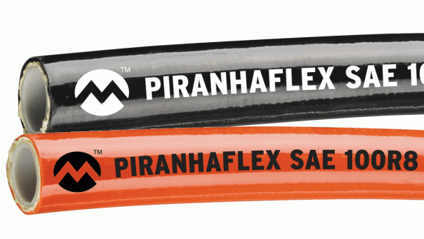

Piranhaflex 100R8 hydraulic hoses are designed for high pressure hydraulic applications involving hydraulic tools, lubrication lines and man lifts. Series PF628 has a seamless polyester inner tube and black abrasion resistant polyurethane pin-pricked cover. Series PF628NC has a seamless polyester inner tube and orange non-conductive, non-pin pricked abrasion resistant polyurethane cover.
Piranhaflex 100R8 hydraulic hoses are designed for high pressure hydraulic applications involving hydraulic tools, lubrication lines and man lifts. Series PF628 has a seamless polyester inner tube and black abrasion resistant polyurethane pin-pricked cover. Series PF628NC has a seamless polyester inner tube and orange non-conductive, non-pin pricked abrasion resistant polyurethane cover. They are rated for working pressures of 2250 to 5000 psi. Sizes range from 1⁄4 to 3⁄4 in. nominal ID and 0.485 to 1.050 in. nominal OD. They offer minimum bend radius of 2.00 to 4.50 in.
