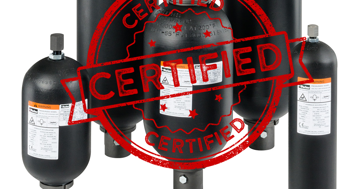

Where in the World Are Your Accumulators Going?
Accumulators are pressure vessels, so they must be certified for the country in which they will be used. This isn’t a problem for equipment sold and used in the U.S., but what if the machine your company produces heads overseas?
By Bill Mosher, Parker Hannfin Accumulator & Cooler Div.
Certifications for accumulators vary—often quite significantly—depending on the application they will be used for and their country of destination. Sorting through the myriad requirements that may be encountered is a daunting task. A truly global certification standard would be the ultimate solution, but that remains all but impossible to achieve due to the parameters that must be met for individual country regulations.
Pressure vessels like accumulators and gas bottles are subject to safety laws, regulations, and ordinances that are valid in the country or state of installation, whether it be the United States, Europe, Asia, or Australia. Additional regulations must be observed in industries such as mining, shipbuilding, and aircraft. This brief article will address the two fundamental design codes and several of the most common certifications. Because many more certifications exist, readers should contact qualified engineers from the accumulator manufacturer to ensure proper conformance to those standards.
