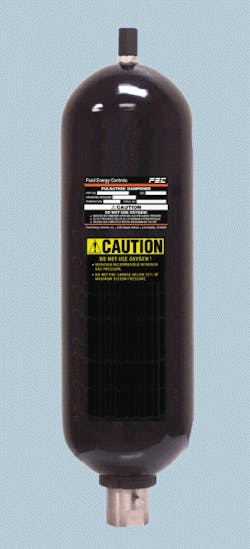

Bladder-type accumulators have proven best for most wind turbine applications. Their vessels are typically made of carbon steel and certain designs can withstand pressures up to 3000 psi. (See sidebar for details on sizing of accumulators.) Inside the pressure vessel is a bladder made of Nitrile compound (Buna-N) or other material as appropriate. Because of its high flexibility and low weight, the bladder has a very rapid response time. If the working pressure is expected to be below 500 psi, a screen can be welded inside the flange to keep the bladder from extruding through the fluid port. At higher pressures, the bladder may extrude through the screen, so a plug and poppet assembly is used. As the pressure drops, the bladder pushes against the poppet and closes the fuel port, keeping the bladder inside the vessel.
Bladder-type accumulators are installed vertically with a gas valve molded into the top of the bladder, and a fluid port at bottom of the vessel. The bladder is precharged to 70 to 80% of the minimum working pressure of the system; this pressure must be periodically verified. Typically nitrogen is used because it is very stable and non-reactive even under pressure. Air is not recommended because of its corrosive properties and risk of explosion under high pressure.
