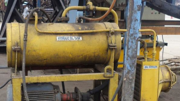

One of our members (name withheld for reasons you'll understand in a moment) sent me this question:
"Our hydraulic power units are Kubota 86 hp and Deutz 76 hp 4 cylinder diesel systems. We use a 40 GPM gear pump with a splitter valve to create two circuits of 20 GPM, each with a variable flow control. We have a diverter valve upstream to combine flows if needed. The gear pump can handle the trash in offshore oilfield hydraulics and is inexpensive compared to piston pumps. The pressure relief valve is set at 3000 PSI.
A gear-type flow divider would be better but is much more expensive. The flow controls we use are inexpensive - but the down side is they create unwanted heat. The flow-through relief valve is another problem source of heat - it dumps past the cartridge port back to tank during normal operation.
The biggest problem we experience is not enough cooling - trying to find a 12 VDC cooler that is not too expensive that can handle salt water (Gulf of Mexico oilfield operations). We looked at a hydraulic fan motor but it was too expensive. This problem could make an interesting article for your blog."

If you are going to go 'cheap' you need to know what you're doing. By that I mean: what you can and can NOT get away with. I don't think it would be possible to come up with a more inefficient hydraulic system than the one described above. Let's take a quick look at what it comprises:
Gear pump - a.k.a. heat generating device
Spool-type flow divider - a.k.a. heat generating device
Variable flow control(s) - a.k.a. heat generating device
Pilot-operated relief valve - a.k.a. heat generating device
Have I upset anyone yet? Write this in blood: EVERY component in a hydraulic system is a heat generating device. But some are MUCH worse, read: more inefficient, than others.
So if you grab a whole bunch of the most inefficient ones and throw them together, you better make sure you've got a BIG cooler. But wait, the 'budget' won't allow for a cooler will it? Darn it then, let's just cross our fingers and hope it will work OK without one. It's false hope.

He knows he's got an overheating problem. And he's also at least vaguely aware that his choice of components is a contributing factor. But he's completely paralyzed by his wallet. Asking: "How can I get this hydraulic system to run cool without spending any more money?" is futile. Because it presupposes there is a magic solution. One which will defy the physical laws at the root of the problem. There is no such solution.
So what is the answer? Well despite this member's protestations to the contrary, I reckon I could design a power unit around a variable displacement piston pump and still be cost-competitive enough to consign his cheap 'n nasty version to the scrap heap. It would definitely be a lot simpler. And it would certainly work out cheaper in the long run.
