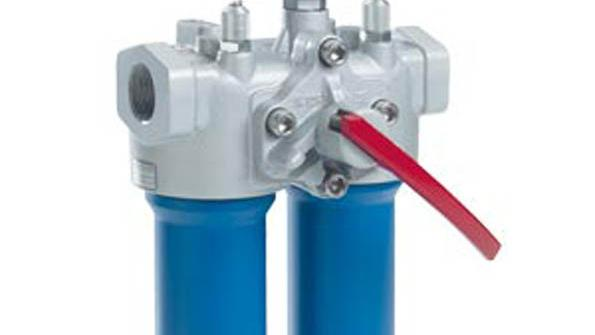

A common symptom of electrostatic discharge in a hydraulic system is an audible clicking noise as charge repeatedly increases and then discharges to a surface of lower voltage through sparking. And this often occurs in a filter - resulting in burn marks and other damage to the hydraulic filter element.

The second reason the incidence of electrostatic discharge may be on the increase, is the change in materials used to manufacture filter elements. Hydraulic filter elements are being made so they are more easily disposed of in an environmentally acceptable way. This has led to the increased use of non-metallic materials in filter element construction and designs where the metal core is part of the housing and not the element. The combined effect of these changes has been to lower the conductivity and increase the capacitance of hydraulic filter elements.

Well, while grounding of the hydraulic system reservoir, piping and filter housings prevents arcing to nearby conductors, it does not prevent electrostatic charging of the fluid or filter media, nor does it accelerate the decay of the charge.
However, the charge generated in hydraulic filter elements can be reduced by increasing filter size. This reduces flow density through the filter and therefore the amount of charge generated. And increasing the volume of oil in the hydraulic system, by increasing tank size for example, extends the time between successive charge generations and also increases the available time for the charge to decay.
