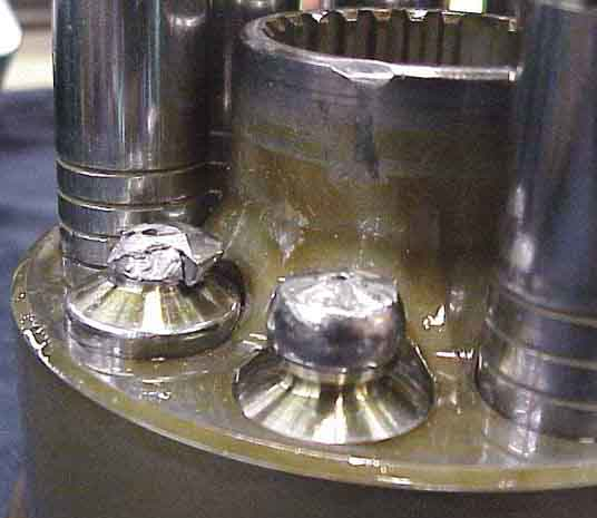

Low oil viscosity causes loss of lubricating film strength. If load and surface speed remain constant, but elevated operating temperature causes oil viscosity to fall below that required to maintain a hydrodynamic film, boundary lubrication occurs with the possibility of friction, scuffing and adhesive wear.
Exhibit 1 shows how this can manifest itself in an axial piston pump. The gold-colored varnish deposits are evidence that this hydraulic system has been operating at excessive temperatures. Due to low oil viscosity, the lubricating film between piston and bore has been lost. The resulting friction has super-heated the piston causing it to expand in its bore to the point of interference. Once this happens, the resulting tensile force pulls the slipper(s) from the piston(s) -- a.k.a. catastrophic failure.
    Exhibit 1. Catastrophic failure caused by low fluid viscosity With the above problems in mind, the perfect hydraulic fluid would have a viscosity index (the change in a fluids viscosity relative to temperature) represented by a horizontal line intercepting the Y axis at 25 centistokes, see exhibit 2.
