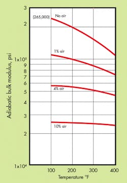

Loss of bulk modulus — Free or entrained air in the hydraulic system reduces substantially the effective bulk modulus of the system. That is, an air-oil mixture appears to increase the compressibility of the fluid, making the system spongy.
Test data seems to indicate that dissolved air has no effect on bulk modulus, providing the air is in solution. These facts, at first, appear paradoxical. However, if one visualizes a container filled to the brim with marbles (which represent the oil molecules) it is possible to pour in a fluid (representing air) around them, or remove the fluid with no change in volume. The weight of the container changes but not the volume.
The compressibility of MIL-H-5606 at 3000 psi increases considerably with only small increases in entrained air content.

Temperature Effects — A temperature rise in a system containing air affects the bulk of modulus of the air-oil mixture. The bulk modulus, which may be much lower than, desired because of free and entrained air, new drops further. (See graph) An increase in temperature also tends to liberate more dissolved air. This effect is usually evidenced by the increased amount of foaming in the reservoir.

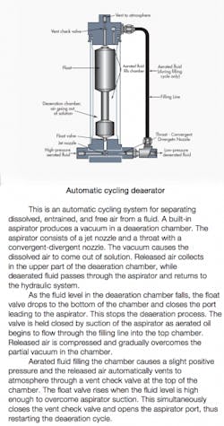

Entrained air is that suspended in a fluid and normally exists the form of small bubbles. Filters or screens that have a low bubble point can remove entrained air
Dissolved air is that in solution in a fluid. Because it is neither free nor entrained air, it does not behave according to Boyle’s law. It does, however obey Henry’s law: the weight of gas dissolved in a liquid is proportional to the pressure of the gas. It can be removed by two methods: subjecting the fluid to a reduced pressure and/or raising the fluid temperature. Its presence or absence does not affect fluid volume.

There is free air in a system before it is filled. Conventional fill and flush techniques will remove the major portion of it. However, some pockets will remain, depending n component and circuit design. Without a very low-vacuum fill procedure, it is next to impossible to remove them. When filling under vacuum, the fill fluid should be deaerated; otherwise it will release air when it comes in contact with the vacuum. Deareted fluid could adsorb some of the air in these pockets.
Where you deal with entrained air in an open-reservoir-system, a low bubble-point filter or mesh will help screen out the entrained air bubbles. To remove them entirely, the fluid should be processed through a deaerator as described above. Also, reservoir return lines should be placed well below the fluid level to minimize circulation and vortices.
Dissolved air is the hardest of the three types of air to remove y conventional means. The bulk of it can only be removed in the presence of a vacuum.
Creating a vacuum in a reservoir to remove dissolved air only damages the pump. (One of the primary purposes of a pressurized reservoir is to prevent pump cavitation, which occurs when a vacuum is created at the pump inlet.) Since the amount of dissolved air removed is proportional to the degree of vacuum, the best technique is again to use a deaerator, which will remove all forms of air in a circulating system.
Note that even when a deaerator of large capacity is used continuously in a system, the deaerator can bring an open system’s dissolved air content down only so far before the deaeration rate equals the rate of readsorption of air taking place in the open reservoir.
