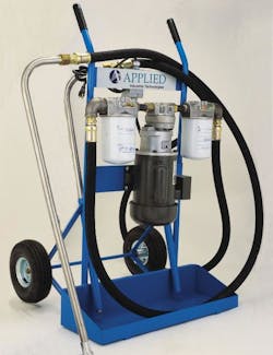

    Off-line filters, sometimes referred to as kidney loops, can achieve very fine filtration by maintaining steady-state flow that can filter fluid whether the main hydraulic system is running or not. (Kidney-loop circuits often contain a heat exchanger to keep hydraulic fluid within an optimum temperature range.) The entire hydraulic system can keep operating while the kidney loop filter is being serviced, or the kidney loop can clean the fluid in the reservoir while the hydraulic system is shut down.
    A kidney loop draws fluid from the reservoir, pumps it through its low-pressure filters, and returns it to the reservoir. Filter elements in a kidney loop are easy to reach, so they are more likely to be maintained than filters placed in hard-to-reach areas of the machine. Kidney-loop filters can either be integrated into the main hydraulic reservoir, or they can be incorporated into a mobile filter cart for servicing many hydraulic systems.
    This type of filtration presents opportunities for creative and economical application. For example, a kidney loop running all night can remove an enormous amount of contamination from the reservoir, which will extend the life of all the filters in the hydraulic circuit. Or a filter cart can clean fluid overnight in one system, be moved to another machine to filter its fluid all day, then moved to a third machine for overnight filtration.
    Unfortunately, kidney loop filters do not directly protect components. Their main function is to thoroughly clean the hydraulic fluid. Also, most filter carts require an electric or air motor to drive their circulating pump, so they can be used only where an external source of power is nearby.
    *Cost: $300 to $1500   Benefit: high

    A filter cart allows several machines to share the benefits of off-line filtration.
