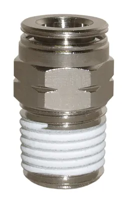

Rugged Metal Fittings
The PN Series is a line of compact, push-in, full-metal fittings suited for heavy-duty pneumatic applications. A stainless-steel gripper and O-ring inside the fitting ensure secure and reliable tubing connections. To connect, users simply push the tubing into the fitting until it bottoms; the stainless-steel teeth grip the tubing and hold it captive. Compatible tubing types include polyamide, polyethylene, and polyurethane. Working temperature is from –4 to 160° F. Working pressure depends on the tubing, but doesn’t exceed 260 psi. Vacuum rating is to 28-in. Hg. The fittings come in a range of styles, including male and female straights, elbows, swivel elbows, tees and swivel tees, reducers, unions, and Y fittings. Sizes vary by style. For example, the PN 11 taper straight male includes 16 variations for tube sizes from ⅛ to ½ in. OD. The fittings are delivered read-to-use with PTFE pre-applied to all threads. They can be disassembled and reconnected several times without the durable PTFE coating peeling off.
C.Matic, +39 0362 805246, www.cmatic.it
