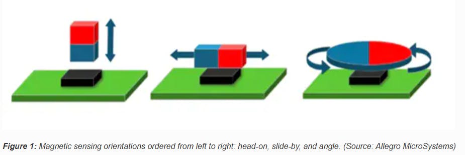

Many modern robotic designs rely on magnetic position and current sensing to maintain accurate motion control in compact designs.
Magnetic position sensors have become a popular choice in robotic systems because they provide non-contact rotational feedback. In robotic arms, these sensors monitor joint position to support smooth, repeatable movement. In AMRs, they support steering systems, wheel-position monitoring, and motor feedback. Traditional mechanical feedback devices such as encoders and potentiometers can experience wear over time, especially in environments exposed to vibration, dust, or contamination. By eliminating mechanical contact, magnetic position sensors can help improve long-term reliability (Figure 1).
Accurate position feedback is especially important in dynamic robotic applications. Small positioning errors can accumulate as a robot constantly accelerates, stops, and changes direction. Depending on the device and implementation, magnetic position sensors can provide high-resolution feedback and fast response times, allowing precise control in dynamic motion applications. In more compact robotic systems, stray-field immunity is valuable because it enables sensors to maintain accuracy even when installed close to high-current motors or switching electronics.
