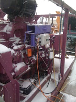

Because high power electric lines are not always present at the well head, diesel engines often provide the power to drive hydraulic systems. In the oilfield control system that he designed for Impact, Braswell attached a linear actuator to the diesel engine to control the throttle, Figure 4.
At start-up, the diesel engine is disengaged from the pump, and the throttle is operated under open-loop control. The Delta controller is commanded to set the throttle position, via the linear actuator, to a predetermined idle position for startup.
Figure 4. The speed and power provided by the diesel engine to drive a hydraulic pump are controlled by the Delta RMC controller, which monitors the speed of the pump and operates the linear actuator (blue structure in the photo) that moves the engine's throttle to keep the pump running optimally as environmental and drilling fluid conditions change.
After the diesel engine is running smoothly, the Delta RMC is put into closed-loop control of the pump speed (speed is monitored by a rotary encoder that is attached to the pump). The controller’s software also checks to ensure that the diesel engine is running. Being able to program and watch the different transducers is critical, especially for determining emergency situations. If the pump’s pressure should drop off rapidly toward zero (for example, if a hose ruptures), the system is switched back into open-loop control so that the engine doesn’t exceed its operating parameters in trying to maintain pressure. During pumping operation, controlling the diesel throttle with a closed-loop motion controller is critical to achieving desired results because the engine’s response to control inputs is non-linear, and its operation is heavily influenced by temperature and other environmental conditions. The controller’s ability to respond quickly to feedback compensates for these factors. When the driller wants to shut the pump down, he or she can switch back to open-loop control before disengaging the pump and shutting down the engine.
