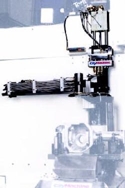

City Machine Tool & Die, Covington, Ky., introduced their Hydro-Coupler system to overcome this problem and more. Their system provides a "through-door" continuous hydraulic connection to hydraulic work-holding fixtures on carrousel-type pallet changers, and it's compatible with most CNC machining centers.
The Hydro-Coupler system integrates the machine tool, control, and hydraulics fixture, providing electronic feedback to the machine control on critical data regarding fixture and hydraulic status. The system automatically monitors clamping pressures, hydraulic pressure and temperature, and responds to irregularities. The result is repeatable and consistent clamping forces.
The Hydro-Coupler provides continuous pressure to 5000 psi. The pressure is applied from the top of the pallet, as opposed to the bottom, so full clamping force is never lost — even while pallets are being rotated in and out of the work cube.
Hydro-Coupler features a continuously connected closed-loop hydraulic system that reduces contamination of hydraulic oil from the atmosphere, while increasing machine uptime by virtually eliminating hydraulic pressure loss.
