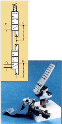

Pictured below are two versions of rugged ductile-iron 1100 Series modulating brake valves: suspended pedal, at left, and treadle, at right. Simplified schematic diagram at immediate left shows typical arrangement when connected for tandem braking circuit.

For a typical tandem braking circuit, as dlagrammed at right, the pressure source is a dedicated pump or an accumulator. With the modulating valve at rest, pressure to both circuits is blocked and return lines from the brakes are connected to tank. When the operator depresses the pedal, the valve shifts quickly through the all-ports-blocked center position and then begins to pass flow to the brake circuits. As brake pressure increases, the pilot forces developed in opposition to the pedal force eventually take command of the spool and shift it to its center position, locking that level of pressure in the brake circuits. When the operator releases the pedal, spring and pilot forces combine to return both spools to their original positions.
