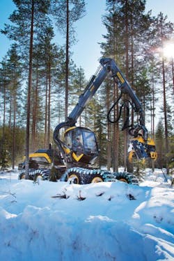

In the logging industry, ever-higher levels of automation have increased log-harvesting productivity. One case in point is the Scorpion, an eight-wheeled harvester by Finnish manufacturer Ponsse Vieremä. The Scorpion processes standing timber into cut-to-length logs ready for transport from the forest to a finishing mill. Its frame is comprised of three parts linked by rotating joints. Front and rear frames are each linked to the center cab frame by these joints. The middle frame is kept level along its longitudinal axis by hydraulics. In fact, a leading feature of the Scorpion harvester is its stabilized design, which comes from its eight wheels and active stabilization system.
Ponsse’s Scorpion tree harvester offers great visibility in all directions and enables flexible operations in harsh conditions. The machine’s crane is fixed behind the operator and passes directly over the cab, providing a centered view of the harvesting head. Given the crane’s mounting position and its reach over the cab to the operator’s front line of sight, a metaphorical mechanical “scorpion” is easy to imagine.
The Scorpion’s front and rear frames tilt according to the contours of the terrain. Its eight wheels may be tires or paired in with treads (front and rear, right and left) for traction in extremely rough terrain and harsh winter weather. The vehicle’s operator sits on the centerline of the vehicle in an ergonomically designed cab. The frame design keeps the pivoting point as low as possible and minimizes tilting, preventing the operator from swaying sideways.
Once a tree is selected for harvesting, the operator maneuvers the crane so that the jaws on the Scorpion’s harvesting head grip the tree’s trunk as a saw blade cuts the tree at its base. The log is then pivoted to a horizontal position, where hydraulic motors rotate wheels that pull the tree trunk through the harvesting head. As the trunk passes through the harvesting head, it strips off the tree’s branches and cuts the log to a predetermined length. After the first section is cut, the remaining length of tree trunk passes through the harvesting head, is stripped of its branches, and is cut to length. This continues until the entire usable length of the tree is cut, then the operator moves on to the next tree.

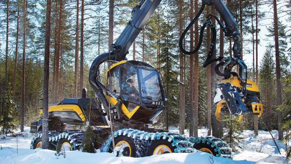

Handling the heavy mass of the tree trunks requires an incredible range of motion and strength, often in demanding weather conditions. Not surprisingly, hydraulics is the only form of power transmission that can deliver this type of performance. Mounted at the end of the Scorpion’s crane is Ponsse’s H7 harvester head. Once properly positioned, the agile H7’s jaws encircle and clutch the trunk of the tree to be harvested. The harvester head then proceeds with its stripping and cutting operations.
Swivels give hydraulic hoses the freedom of movement to prevent the torsional stresses that would otherwise twist them, reducing hose life.
A considerable amount of torsional movement is required of hoses that route pressurized hydraulic fluid between the crane arm and harvesting head. Consequently, hydraulic hoses must be mounted on swivels to prevent twisting hoses’ reinforcing construction, which would cause premature hose failure. In extreme cases, torque transmitted through the hose can actually loosen its end fitting.
The Scorpion operates at pressures reaching 4,350 psi. At this pressure, traditional ball-bearing hose swivels can wear out prematurely. For this reason, after several years of testing, Ponsse engineers selected swivels of a different design: ball-less swivels from Taimi Hydraulics in Canada.
