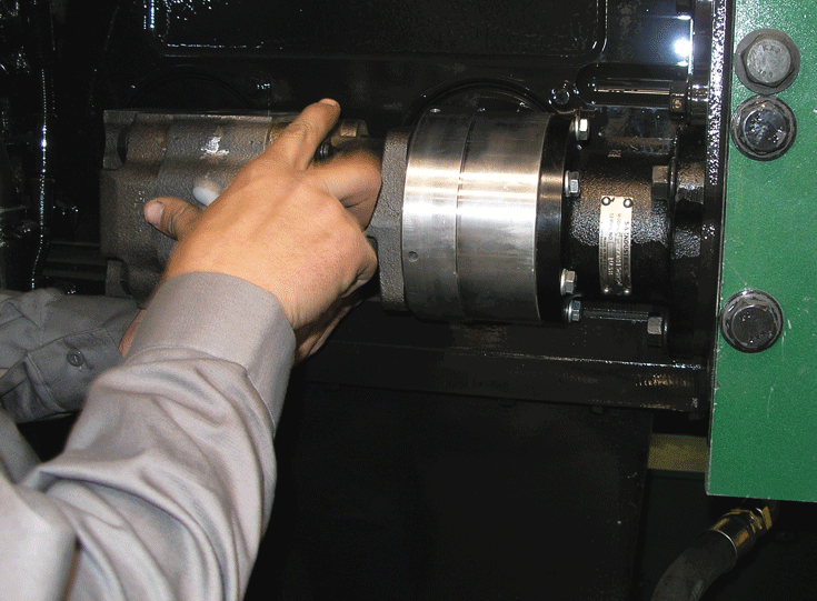

Starting an engine with a displacement of 5000 in.3 requires the high power density, durability, and reliability of hydraulics. Above is a closeup of a hydraulic starter on a machine used in the hydraulic fracturing industry. The hydraulic gear motor is behind the person’s hand, the flange adapter is to its right, and the friction clutch inertia drive is to the right of that.
