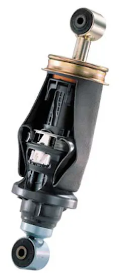

Air-spring module uses a rollingdiaphragm air cylinder not only to isolate shocks and vibrations, but for controlling cab height as well. Whether it’s a truck negotiating the rough terrain of a construction site or a tractor ...

Air springs for higher demands An air-spring module is well suited for installation in vehicles that carry a wide range of different loads — including in the cabin itself. The working element of the air-spring module is a rolling-diaphragm air cylinder. The rolling diaphragm design eliminates the need for a complex seal and its potential for leakage. Instead, a diaphragm keeps air positively sealed within the cylinder.
Georg Memmel, director of engineering at ZF Sachs, says that standard air spring modules have a diameter of 125 or 140 mm, with a maximum stroke to 120 mm. He adds that they typically operate at a working pressure of 4 to 8 bar, but are rated for maximum working pressure to 10 bar.
Memmel explains that mounting an air spring module at each corner of an operator cabin isolates it from much of the shock that would otherwise be transmitted to it from the chassis. A leveling valve controls air pressure of the air spring to match cabin weight and pressure.
The proportional valves can regulate the pressure in the cylinders to control height of the cabin. ZF Sachs integrates its air-spring modules and a mechanical leveling valve for a ride-height control system for the cabin — a system called the Cabin Air Leveling Module (CALM).
