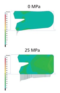

To contend with material deformation, one step cylinder manufacturers can take is reducing the extrusion gap to provide more support for sealing system components. Another is ensuring good alignment. This minimizes the extrusion gap, so the seals do not see localized high-stress conditions. And manufacturers can design cylinders to reduce pressure at the seal, for instance, by adding a mechanical stop to eliminate constant high-pressure loading.
Seal suppliers have two primary avenues to pursue. One involves more-robust components, including changing the design to ensure a seal will not deform to the point of severely impacting performance; adding components such as backup rings to limit deformation and stress; and changing to materials with higher load capacity.
Seal manufacturers can design components to ensure they do not severely deform at high pressure and impact performance. An example is shown in this FEA model.
