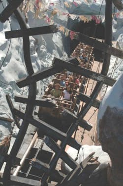

Upon departure, the train ascends the attraction's first hill. After climbing a second hill, 112-ft high, the coaster enters a snowy canyon. Something appears seriously wrong. Huge footprints in the "snow" and a distant roar signal that the guests have infringed on the yeti's space. Worse yet, the track ahead is broken and twisted — with nowhere to go except off the track and over a steep cliff!
Lacking any other recourse, the train comes to a halt, then backs up. But instead of heading back into the loading area, it crosses over a switch track that diverts it — backwards — to an alternate route. The coaster continues backward and up through a spiral and eventually stops at the top of an incline. After a brief pause, it rolls forward down the hill, then crosses over another switch track that sends it down an 80-ft drop. The coaster reaches speeds up to 50 mph.

Guests discover they cannot continue their present course because it appears the yeti has destroyed the track ahead of them. Their coaster train then backs up over a switch track operated by pneumatic actuators — a first in coaster design.
