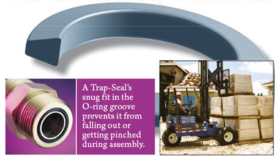

Eventually, technicians pinpointed missing or pinched O-rings in the suspect fitting — a situation likely caused by the difficult-to-reach assembly area of the tightly aligned hose connections. When Princeton confirmed that random seal loss or failure was the cause, engineers at Parker Hannifin’s Tube Fittings Div., Columbus, Ohio, recommended a different O-ring that would virtually eliminate the possibility of seals misaligned or popping out during assembly.
Parker’s Trap-Seal, a trapezoidalshaped O-ring, exerts a positive retaining force in the O-ring face seal (ORFS) fitting groove that prevents it from falling out or getting pinched in the connection. Compared with conventional O-rings, Trap-Seal has a larger overlap between the groove lip and seal, which keeps it snugly in place. And because Trap-Seal is made of the same 90-durometer nitrile material as Parker’s standard O-rings and fits in standard SAE J1453 halfdovetail grooves, the changeover for Princeton was easy.
“The results were immediate,” says Pohl. “Incidences of random and unexplained failures plummeted, and have been virtually eliminated since we’ve been using Trap-Seal.” The product is now standard on Parker Seal-Lok ORFS fittings.
