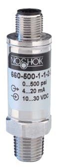

Micro-size pressure transducers
Compact Noshok pressure transducers are designed to handle pressure spikes and process pulsation. The devices feature a welded stainless-steel pressure chamber for strength and durability. Features of the transducers include up to ±0.25% full-scale accuracy, standard ranges from 200 to 15,000 psi, and a sputtered thin-film sensor that provides stainless-steel media compatibility and long-term measurement stability. Specifications include output signal: 4 to 20 mA two-wire, 1 to 5 Vdc three-wire; 0.1 to 10 Vdc, three-wire; ≤ ±0.05% full-scale repeatability; ≤ ±0.5% full-scale hysteresis; ≤ ±.2% full-scale stability for 1 year, nonaccumulating; and <2 msec (between 10 and 90% full-scale) response time.
