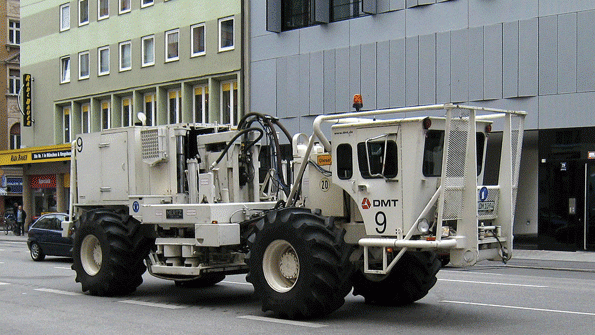

As you might guess, the first seismic vibrators were mounted on commercial trucks fitted with a second engine to power the hydraulic system. These units were well suited to over-the-road travel between jobs but were less practical for off-road positioning. Most current production vibrators are purpose-built off-road machines that are trucked from one job to the next. They may be wheeled or tracked, depending on the off-road conditions where they will operate.
For off-road travel, a hydraulic motor drives a differential on each vibrator axle so that both are live. The axles are fixed to the vibrator frames, many of which are articulated for maneuverability. The frames have a three-degree-of-freedom joint just behind the operator’s cabin. Hydraulic cylinders between the two frame halves steer the vehicles.
