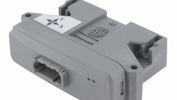

Dual-axis, CAN-based slope sensor
The PLUS+1-compliant CSS1000 inclinometer, features MEMS (microelectromechanical system) technology for stable output. The CAN 2.0 B-compliant device cancels out transverse machine motion, providing a fast-responding and stable slope signal. The dual-axis slope sensor also features a MEMS gyroscope to measure acceleration around the axis. Each axis has an operation range of ±12.5° (±22% slope).
The PLUS+1-compliant CSS1000 inclinometer, features MEMS (microelectromechanical system) technology for stable output. The CAN 2.0 B-compliant device cancels out transverse machine motion, providing a fast-responding and stable slope signal. The dual-axis slope sensor also features a MEMS gyroscope to measure acceleration around the axis. Each axis has an operation range of ±12.5° (±22% slope). The IP67-rated sensor also features a 12-pin connector and 9 to 36-Vdc power su
pply range.
