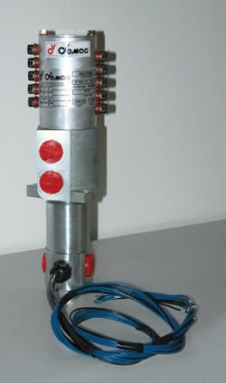

Another type of specialty rotating manifold transmits electrical and fluid power from a stationary component to a rotating one.
