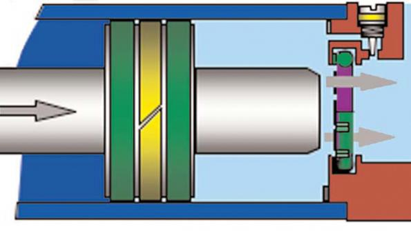

Avoiding The Bounce
As piston moves from right to left, exhaust air vents through the center of the end cap (top). The cushion sleeve engages the cushion seal, blocking free-flowing exhaust air (middle). Exhausting air can only escape past the ...
As piston moves from right to left, exhaust air vents through the center of the end cap (top). The cushion sleeve engages the cushion seal, blocking free-flowing exhaust air (middle). Exhausting air can only escape past the cushion adjustment screw. The exhaust air quickly compresses, providing pressure to decelerate the load. The screw is adjusted to the application to bring the load to a gentle stop (bottom).

As the piston nears its end of stroke, it must be decelerated before reaching end of travel. The most accepted method for deceleration is air cushioning. Air cushioning is the result of the piston rod entering the cylinder's end cap. The air in the cap is squeezed or compressed, resulting in a negative force acting upon the piston.
Conventional air cylinders rely 100% on the non-linear air cushion to decelerate the load by compressing the gas in the cylinder's controlled volume at the end of stroke. As an air cylinder is traversing through the stroke, a constant velocity is achieved by controlling the exhaust flow out of the cylinder. This exhaust flows freely out of the cylinder through the center of the end cap downstream to the flow control. As the cylinder nears the end of stroke, the cushion spear of the sleeve enters the cushion seal, eliminating the free flowing exhaust path. The controlled volume now decreases without an exhaust path, and the gas compresses. Exhaust is then metered out through the cushion needle, for desired cushion performance.

Adjustable air cushion
To control, or meter, the volume of air being released during the compression phase at end of stroke, an adjustable cushion is used (see illustration on page 46). This typically consists of a threaded needle screw that adjusts into an orifice in the cylinder end cap. By adjusting the screw further into the orifice, the amount of air that can escape in a given time is reduced. Slowing the exhaust of air creates back-pressure, slowing the piston as it enters the end cap. The slower the air exhausts, the more dramatic the deceleration.
