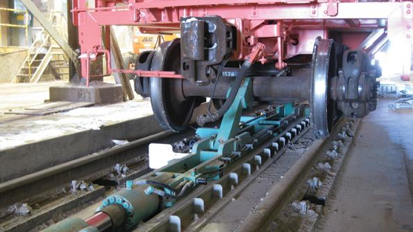

A much more effective method of indexing rail cars is to use a hydraulic rail car mover, designed and manufactured by Calbrandt Inc., Delano, Minn. Calbrandt’s rail car mover is used for positioning a strand of up to sixty 143-ton rail cars for loading or unloading bulk media, such as grain, oil, coal, wood chips, or gases. The machine has arms (called dogs) that rise from ground level and push on the axle of a rail car to move it forward with controlled motion to a desired position. Depending on the setup, it can move cars at speeds to 60 ft/min and generate 75,000-lb of thrust.
Calbrandt’s rail car mover uses a set of five hydraulic cylinders to move and position rail cars for loading and unloading. The cylinders can produce a stroke exceeding 78 ft and can move up to sixty 143-ton cars at a time. (Click image to enlarge.)

Rail car mover uses colinear cylinders mounted end-to-end and that transmit hydraulic fluid from the rod end of one cylinder to the end cap of the next. This configuration eliminates any external fluid line connections except for direct connections to the pump and tank lines.
The operator of a rail car mover stands near the area where the loading or unloading will occur. This allows the operator to view the position of the car directly. Operating sequences are provided by an Allen-Bradley PLC through a human-machine interface. The PLC, in turn, commands solenoid-operated hydraulic valves.
Calbrandt offers two types of rail car movers, depending on productivity required for the respective installation. An indexer type pushes the axle of a rail car using a single length of hydraulic cylinders mounted end-to-end and positioned parallel to the rail. A 118 -in. bore hydraulic cylinder with 6-in. stroke raises an axle dog from the floor to engage the axle of the rail car, then the colinear cylinders extend to move the car.
The axle dog then drops back below floor level, and the cylinders retract back to their home position while the rail car is loaded or unloaded. The machine is then set to begin another push cycle. A progressor type mover uses a pair of cylinder assemblies to push a rail car in a continuous motion along the length of the track. While one set of cylinders is retracting, the other is extending — a sort of walking motion that moves cars at a uniform speed.
In either case, the car mover is configured to move cars in either direction along the rails, with cylinder extension or retraction as the work stroke. The system can generate up to 55,000 lb of thrust at a system pressure of 1660 psi during extension or 3185 psi during retraction.

Calbrandt’s standard rail car mover consists of five cylinders mounted end-to-end in a colinear arrangement. The first cylinder is stationary, and when its rod extends, it pushes on the cap end of the second cylinder. Likewise, the rod of the second cylinder pushes on the cap end of the third cylinder, and so on. This means that, theoretically, the rod end of the second cylinder moves at twice the relative ground velocity as the first one. This is because the body of the second cylinder (which is mounted on rollers, as are the third, fourth, and fifth cylinders) moves at the speed of the first cylinder’s rod, and the rod of second cylinder extends at that same speed. Therefore, the rod end of the fifth cylinder moves at five times the ground velocity as the first one.
In actuality, the stroke speed of any given cylinder varies. The piston acting against the least resistance will move. However, the net result is uniform motion from the cylinders sharing fluid routed in parallel.
However, probably even more unusual is the plumbing arrangement. The pump and tank lines from the hydraulic power unit are both connected to the end cap of the first cylinder. Both fluid paths in the cylinder are routed so that they exit from its rod end. A flange on the rod end connects to the end cap of the next successive cylinder and routes fluid into its pump and tank ports, as shown in the illustration. This configuration is repeated for the third and fourth cylinders, and the fifth cylinder simply has a connection to a mechanical linkage on its rod end.
