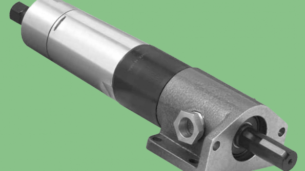

Rotary vane design
Figure 1B — This vane motor is intended for applications having limited radial space. Because of its small OD, this motor transmits low torque at high speed. It has an integral planetary gearbox to increase torque and reduce speed.
Rotary vane air motors are typically small in size and deliver high speeds and low torques. In an application where a high-speed/lowtorque power source is required in a limited space envelope, the rotary vane motor is an excellent option. These motors are well suited to machines used in printing, packaging, food processing, canning, and bottling. Because of their design, rotary vane motors can be fitted with various abrasive wheels, cutting tools and used in machining, grinding, and drilling applications.
